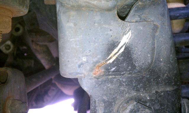

It is is the front one, and I was just driving home from work when I noticed my steering wheel had become crooked. I have had issues with a drop bracket which I ended up welding to stop it from shifting, which now seems to have made the factory bracket a weak point...
Here is a picture of the cracked bracket.

Drill stop the ends with a hole diameter at least 2 x the thickness of the metal. Vee out the crack and weld it up. that will hold while you figure out why you broke it. You could add a stiffener to it--a vertical rib.
