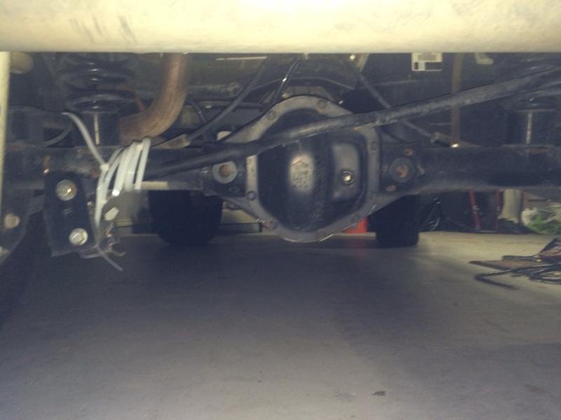

Heres a pic of the track bar and how we limped it back home

That is (was) a raised rear bracket that came with the lift? If you don't opt for a weld-on bracket, there are some decent options that use big ubolts around the axle tube.
Yeah what he said.. Is that a raised track bar bracket? The angle looks high on the right.. Most lifts I've seen have a bracket that mounts to the right, lowering the mounting bolt..

I don't believe that is and after market bracket but not 100% sure as we werent the ones who installed the lift. When i looked closer yesterday it seemed as though when the bracket broke it cracked the axle houseing so looks like we will be in search of a rubi take off or a d44
Highly unlikely. You're probably just seeing a low point from welds being torn out. Post up a better pic when you can.
