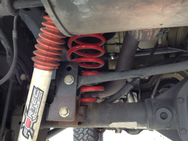

Originally Posted by marmot74
What about just braces like what JKS makes? Worth it? Do the trackbar brackets break as much as people say?
Thanks!
I just changed out alot of parts over the last month due to simply that were crap (skyjacker) or were just worn out (front and rear driveshafts, tie rod and drag link, new shocks, front and rear track bars and the rear track bar brace).
When I removed the old bracket (like the ones they include in cheap lifts), I noticed that the factory brace was badly bent. I bent it back as best as I could and added the JKS bar and brace which secures to axle on two points for a better and tighter feel when driving. In addition, i noticed a HUGE difference when making turns and hard braking!
I would recommend this combo to anyone. Here's before and after pics...
