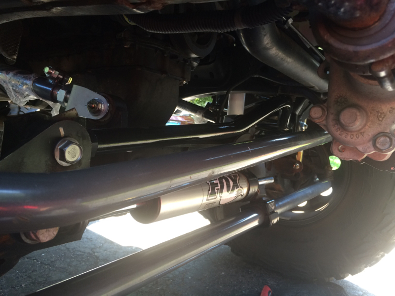

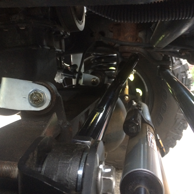

Take a look at the new Superlift TB's. I got this as a gift, and previously would not recommend a Superlift product. This track bar is very nice, it utilizes 2 patent pending Dual Durometer bushings similar to synergy's. The jeep handles better BUT I did discover a worn Heim joint. Totally worth $119

how many miles on the hemi joint that was worn? $119 is a deal for sure especially if it is a nice piece.
Maybe 6k or less.
