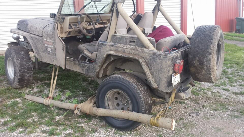

Had a buddy break a rear shaft on a yj, we used a log and put it against the side of the tire and ratchet strapped it to the other side. Probably a lot more but I can't think of any.
