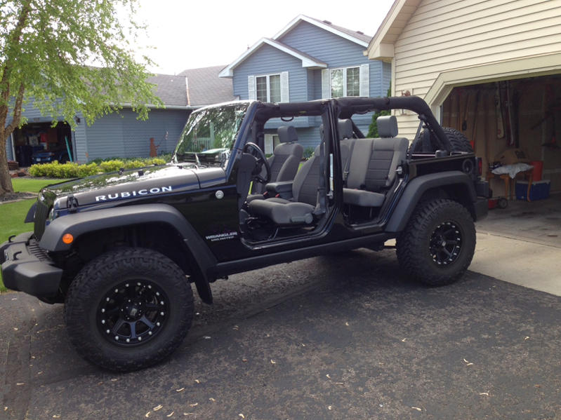

I have the 2 in AEV lift with mud grapplers 295/75 17 which measure out just above 33
I've been off-roading in Moab with them for the most part there isn't any issues except when the rear is articulating you will stuff the tire in the rear fender and it will loosen the plastic fender. Easy fix.
To be honest I wish I had a half inch more lift or different fender flares just so it doesn't rub.
Over all though it is a great combo for mild 4 wheeling

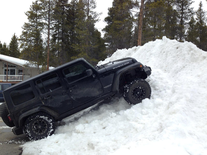

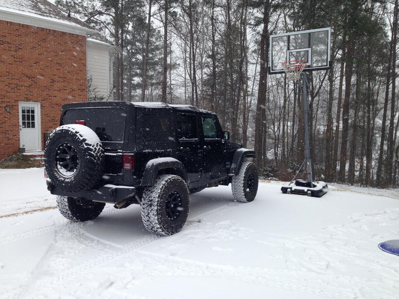

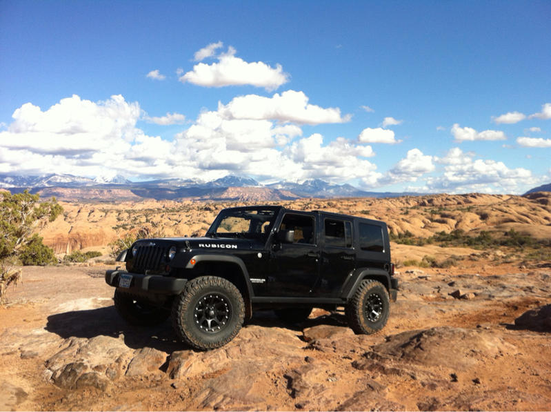

Think you could post a pic of your setup?!
Old May 18, 2014 | 10:47 AM
Jake7978's Avatar
Posts: 168
From: Chanhassen, mn
The one in the snow you can see how the tire flexed into the fender

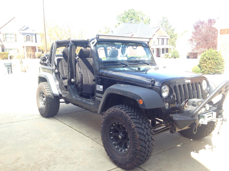

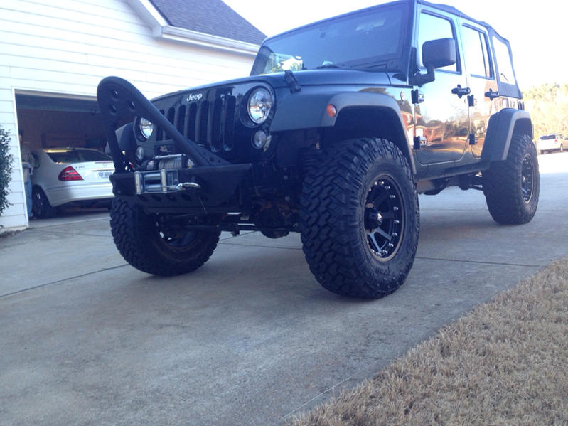

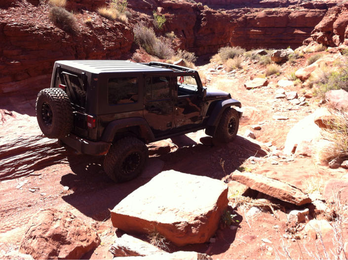

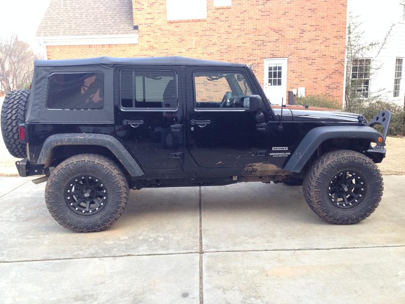

Nice setup! love the wheels and tires But i was making a choice between the two tires and I actually wanted the Toyos but they where on backorder at the time. Got the Grapplers and couldn't be happier.
