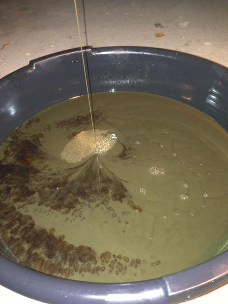

Based off this picture, should I change my tranny fluid? I'm worried some water may have gotten in. I already changed engine oil and both diffs. What would you do? How hard is it to change the tranny fluid? This is a manual trans.

How many miles on the trans oil? Maybe it should be changed anyway.
If it's not time to change it, pull the fill plug and see if the oil is foamy or milky.
Or, carefully pull the drain plug to see if any water comes out.

It's got about 10500 miles on it. I ask because this is what came out of my diffs. Don't want the tranny looking like that.
If that's 10,500 on the Jeep, I would change the trans oil just to get the break-in residue out of it.
I like to do all the first fluid changes early for that reason.

u could always check it... do it if your worried but I wouldn't worry about that lil bit of mud
