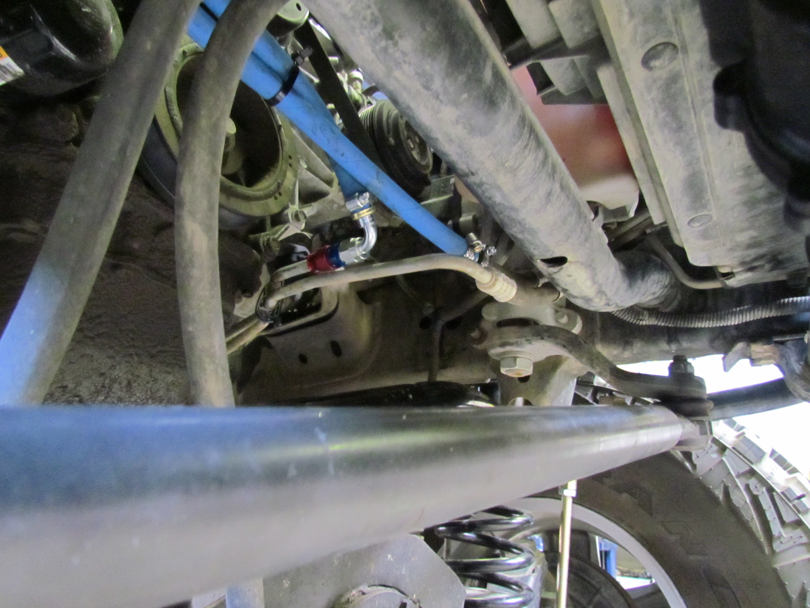

Another option that works as good as the factory but cheep as hell.
Just get a used Ford 2000-2003 trans cooler and some 3/8" line with 3ea 3/8 compression to 3/8" barb connectors.
One fitting for the cooler..forgot exact part # sorry
Cut then new cooler into the cold line coming from the radiator line back to the trans and install the new cooler lines.
ID:	626388   Click image for larger version

Originally Posted by nthinuf
B&M coolers are popular. You can find a an installation writeup up in the JK-Writeups area. (there is an Index stuck to the top, check the Performance section.)
This is actually a very good addition for these 3.8 auto's.
If you use this write up your lines that you splice into will eventually start to weep fluid. Do yourself a favor and cut off the aluminum caps and connect the hose the the barbed fitting on the factory hard line. Mine has been good ever since I ditched the factory fittings and used fuel hose clamps. I posted a picture and parts list I used in the modified tech section.
