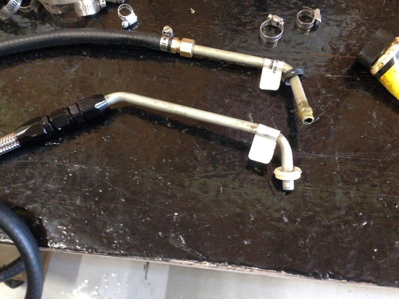

Install a Cooler and splice in a new line ..I did both braided line and rubber hose ....Jeep wanted me to split the cost w the Dealer ...
...and the Dealer is installing same OEM line that's gonna leak again .....
My lines are over 2 years old NO Leaks !!

That's a nice setup you have there⬆️⬆️⬆️. Wish I would've done that. I just did the normal splice using the barbs included in the kit. No leaks but if it does I'm doing it your way.
