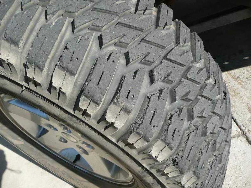

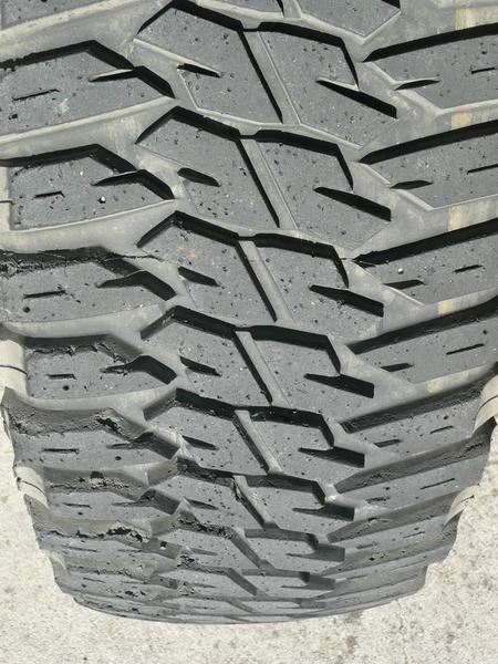

Originally Posted by unlimited12
with 15k on them how do they look? how many more miles you think you'll get? I have been looking to get that same tire
Here are a couple pictures I took after I came back from a trip to Hollister a couple weeks ago. I beat the crap out of the tires on a couple of particularly nasty rocky trails on which there was a lot of wheelspin. I was the only one in the group who made it up one of the rocky double-black-diamond trails without a winch. It tore up the tires a bit, but that's what they're for, right?

They have roughly 15,000 miles on them with a total mix of highway, city, and offroad miles. Besides the sharp rocks at Hollister, they've also seen the smooth rounded granite of the Rubicon and surrounding trails, as well as miles and miles of desert 2-track. I'm not easy on my tires, but you can see how even the treadwear is, with no cupping or feathering. Of course the leading edges of the treadblocks that spin against the rocks get chewed up, but there's been no major chunking.
If you look closely, you'll see the pits that are left behind in the treadblocks after the glass and walnut shell particles come out. It's hard to tell in these pics, but you can also always see freshly-exposed glass and walnut particles still embedded in the tire, which act like miniature snow studs in the ice. I'll tell you, these tires fully get it in snow and ice. The Kedge Grip is not a gimmick - it makes an immediately noticeable difference compared to non-studded tires.
Based on my past usage, I'd say these are easily a 40,000-mile tire. But I replace my tires before they're fully bald, so I could probably extend it to 45,000 or 50,000 miles if I was super-cheap.
Unless a better tire comes out on the market, I plan to purchase another set of these. I absolutely love these Guard Dogs.

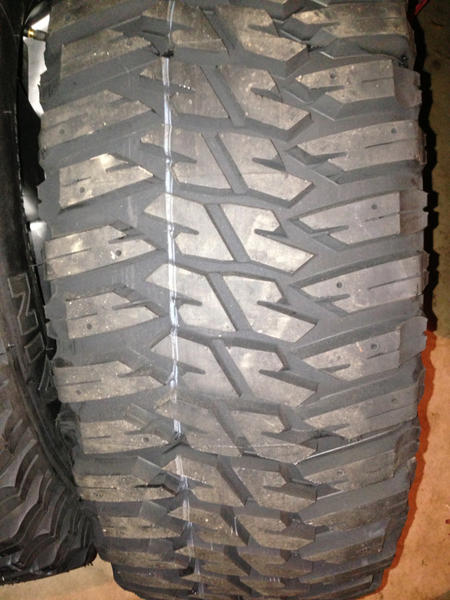

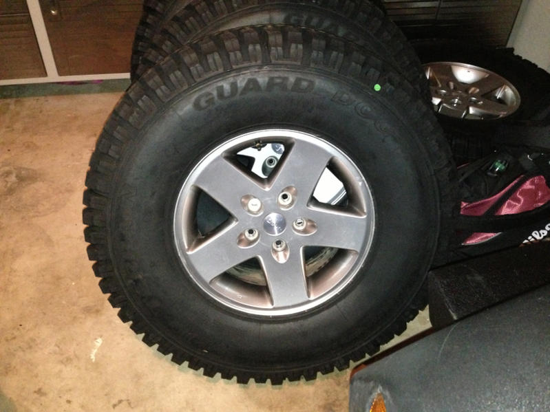

Here are my new ones mounted up. Absolutely no complaints from Firestone who balanced them. I can't stand to wait, but I'm going to put them on the Jeep Friday when I've got time. That's about 44 hours and 15 minutes away, but who's counting?

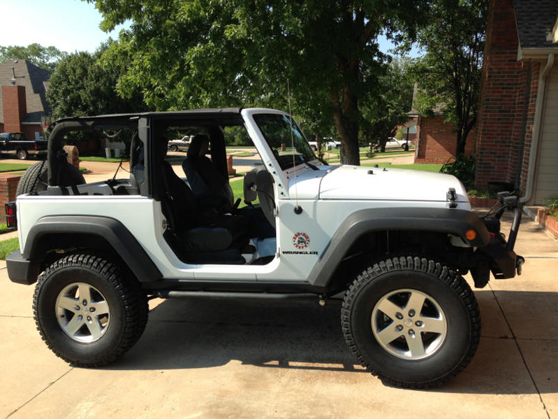

Got my ace rear bumper with tire carrier on the way from northridge too!
Measures 34.25" mounted up.
