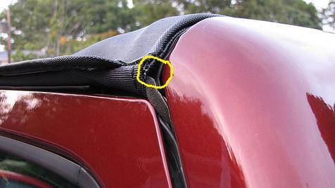

I have been watching this thread and doing my own testing looking a fix for this and what I have found is that you need to fill or cove the opening in the fabric. I covered mine with electrical tape as a test and it was nice and quiet. The weather stripping worked but did not stay stuck to the top once I rolled it back and I didn't want to stick it to the jeep. So I am still looking for a long term solution. I circled the fabric area in the picture below that I covered with tape.

I found a simple fix to the noise on complete accident when I installed my top and one side had the small flap with the foam padding on it folded at a 90 degree angle from where it is supposed to be.
Looking at the drivers door, if you take this piece and rotate it counter clockwise 90 degrees and tuck the right end up into the top snugly. This removes the area where the wind enters the top and almost completely eliminates the noise. I will see if I can get a picture later on and figure out how to attach it.

So far the best wind noise fix for me was adding another piece of stripping right next to the pad that comes installed as new. It cut 85% of the noise. I'll try the 90 degree fold next. That makes a fair amount of sense.
