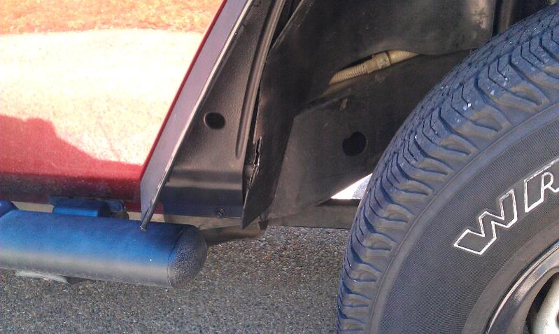

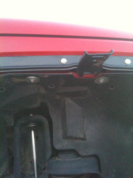

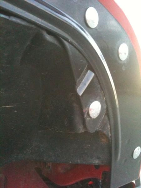

Ok I have pics. What I did was take off fenders and remove the inner fender from the outer fender and used the one that covers the motor. Then placed that inner fender in wheel well by hand and notice the two stock bolt up hole locations right under the tab area (I used a bigger washer on those). Then I put that long weird looking black bolt in and tightened it in. I proceeded to use a pen and run a line down the edge of the body to mark were to cut the excess fender sticking out. Next I put 1/4 carriage bolts in the old holes that the plastic rivets went in for a bold finished look, then cut the inner fenders to size. There is one hole in the very front of the inner fender that I put a bolt in to hold it solid from the wind. Last I had to used a self tapping screw on the bottom by the pinch seam to keep it from flopping around. Piece of cake.
