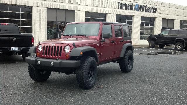

Got my lift on yesterday and wheels and tires installed today. My tires are rubbing at full turn on the front plastic "skid plate" if there is such a thing as a PLASTIC skid plate. Has anyone else had to trim this back?
3" BDS suspension lift
35/12.50/17 toyo m/t on mt classic III

Old Jan 14, 2013 | 03:31 PM
sky's Avatar
sky
Posts: 263
From: Omaha, NE
Rip it off and throw it in your recycling bin

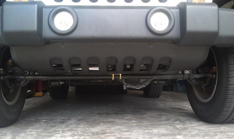

Yes trim it or toss it.
I customized mine by cutting the slots out too. (I don't know why)

Old Jan 14, 2013 | 03:35 PM
MikxHayward's Avatar
Posts: 134
From: Ontario
X2. It's coming off on the trail if you don't do it now.
Cavallini03's Avatar
Posts: 37
From: Massachusetts
That's the air dam, I believe it's just there to help direct air flow under the jeep. It might offer some protection, but it would be very minor. I ripped mine off a long time ago and threw it away, you can do that or just trim the sides where you tires rub.
<img src="https://www.jk-forum.com/forums/attachment.php?attachmentid=409536"/>
Yes, you can easily trim the "wings" off each end, or use a heat gun to fold the wings back toward the engine at a 90 degree angle to give additional tire clearance. The plastic serves only as an air dam. It will reduce your highway gas mileage if you take it off and don't replace it. Jeeps are already aerodynamic bricks and you don't have to make it worse for no reason. Also don't cut any holes in it (like one of the other posters). Otherwise you might just as well trash it in that case.
Old Jan 14, 2013 | 04:19 PM
Gman*2007's Avatar
Posts: 2,552
From: Huntsville, TX
I took a dremel tool die grinder and cut off the wings on each side and smoothed it up with a file. You can't even tell it was cut.
