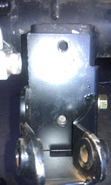

one of my pics from my rockstar install. you can see LCA bolt is threaded through, and you can see the upper bolt hole is flush and lined up. but look at that lower bolt hole! The rockstar is clearly in place (because there isn't much wiggle room with that LCA bolt), and the specs are just way off.
the pic pretty much sums up the install for me!
