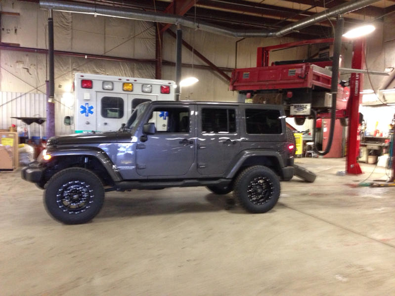

I guys tried calling Teraflex but they are closed. I installed a BB lift in my buddies 14 JKU and I really do not like the brake line relocation brackets for the rear but ok. The issue I have is when I installed the front lift the brake lines pull even with the bracket disconnected from the frame when the suspension hangs and before someone asked yes the shocks were installed... everything was back on, so I had to remove the bracket by the spring perch and discard it completely I temporarily zip tie the lines to the shocks but I do not like it at all,, so with all the expertise here I am sure someone else must have ran into this issue.., the instructions showed nothing even searching install video came up with nothing so any advice is appreciated
Here's the completed Jeep new tires and lift
