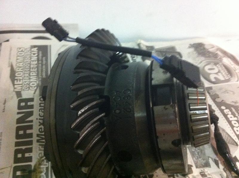

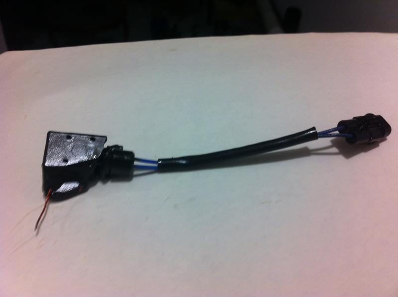

i have a problem with my front tru-lok locker... the electromagnetic part on the locker its broken i already search for a number part but i cant find it ..... does somebody knows something about this part?? does it came with all the locker ??? or can i buy it only the electromagnet?? Click image for larger version

No parts available. Your best bet is to find a used locker that broke in some other way.

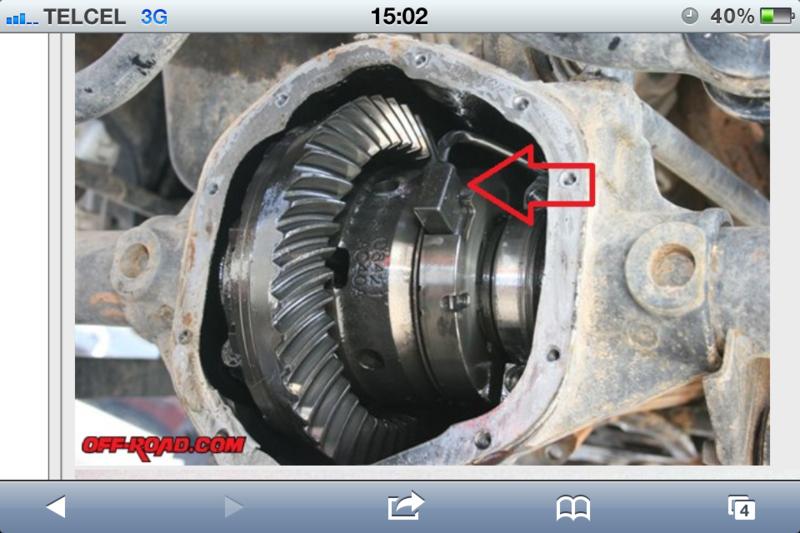

Did the connector break because the locker rotated in the housing?
If so...
Before you removed it, did you notice if the anti-rotation tab was engaged on the locker?

indeed.... the locker rotate in the housing and the anti-rotation plate was not properly engaged..... i already have been looking for a new locker in quadratec and other online shops but i have no luck......DOES ANYBODY HAVE OR KNOWS SOMEONE THAT CAN SELL ME A USED TRU-LOK LOCKER WITH THIS PART INTACT?? =(

I'm having this same problem right now I believe. I have yet to open the rear diff cover, but from what I've read if your tab wasn't in, spun the locker and snapped the wires, you should be able to cut apart the hard rubber or plastic black piece to expose more wire and make a connection of the 2 again. As well as get a new anti rotation tab (actuator bracket) as mopar calls it for about $4.
