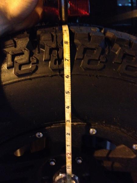

My Cepek FC-II's are aaaalmost a full 33. Not quite though. I spent a while looking at 33's because I wasn't going right to 35's. The Cooper STT's I had on my TJ ran a little small. Cooper makes Mickey Thompson and Dick Cepek and I think all of theirs run small (from what I've seen when shopping around). Toyo makes Nitto and I think they both run more true to size. Goodyear has a Kevlar MT that's just over 33 too. Those were all the brands I shopped with.
Cepek's website says the 33x12.5x17 are 32.6 and I believe it. I'm happy with them though for whatever it's worth. This is on a 2" kit. And the 9 on the tape measure would've been 33". Good luck.
