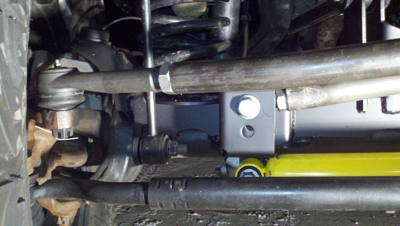

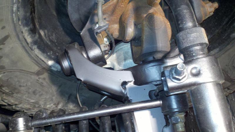

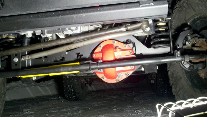

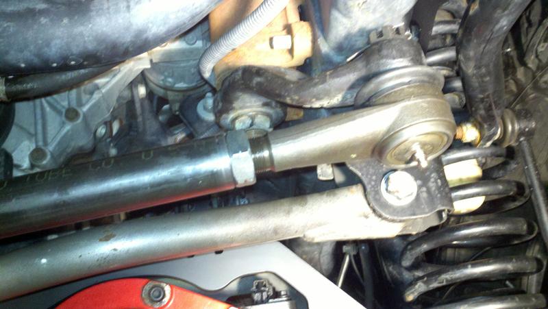

Had this installed today. 100% made in-house by a company I can't mention here, (PM me for the details). They're powder coating the new drag link and re-coating my track bar on Monday. Incredible workmanship and it drives unbelievably better.
Now, before I get flamed for my "drag link and track bar not being parralel, this is part of their design and it works VERY well. Zero bumpsteer.
They basically skinned the axle, and rebuilt the upper and lower control arm mounts (uppers are now raised and very close to factory angle), and tucked in the lowers incorporating skids. The track bar, coil bucket, and stabilizer mounts are all new. All 1/4".
The drag link is also made in house using 1-ton GM ends.
I am very impressed.
