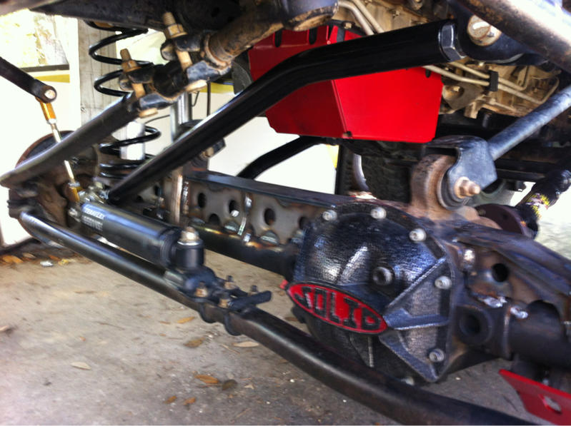

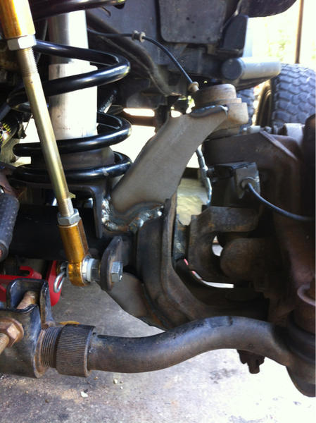

I run the artec truss and gussets. Took me and my welding buddy about 7 hours from start to finish. That's not bad down time at all.
Did you weld it while the axle was on?

Is that welded to the ball joint?
Old Jul 10, 2013 | 07:19 AM
JKred's Avatar
Posts: 1,467
From: Torrington CT
No, just the easiest place to weld is the top of the axle c. It should miss the ball joint by a half inch.
I feel like a broken record. If you can afford the work of a competent welder, or even better, can do it yourself, a truss is THE BEST option for armor of stock axles.
Pure jeep kit on my old D30, Artec kit on my new D44.
