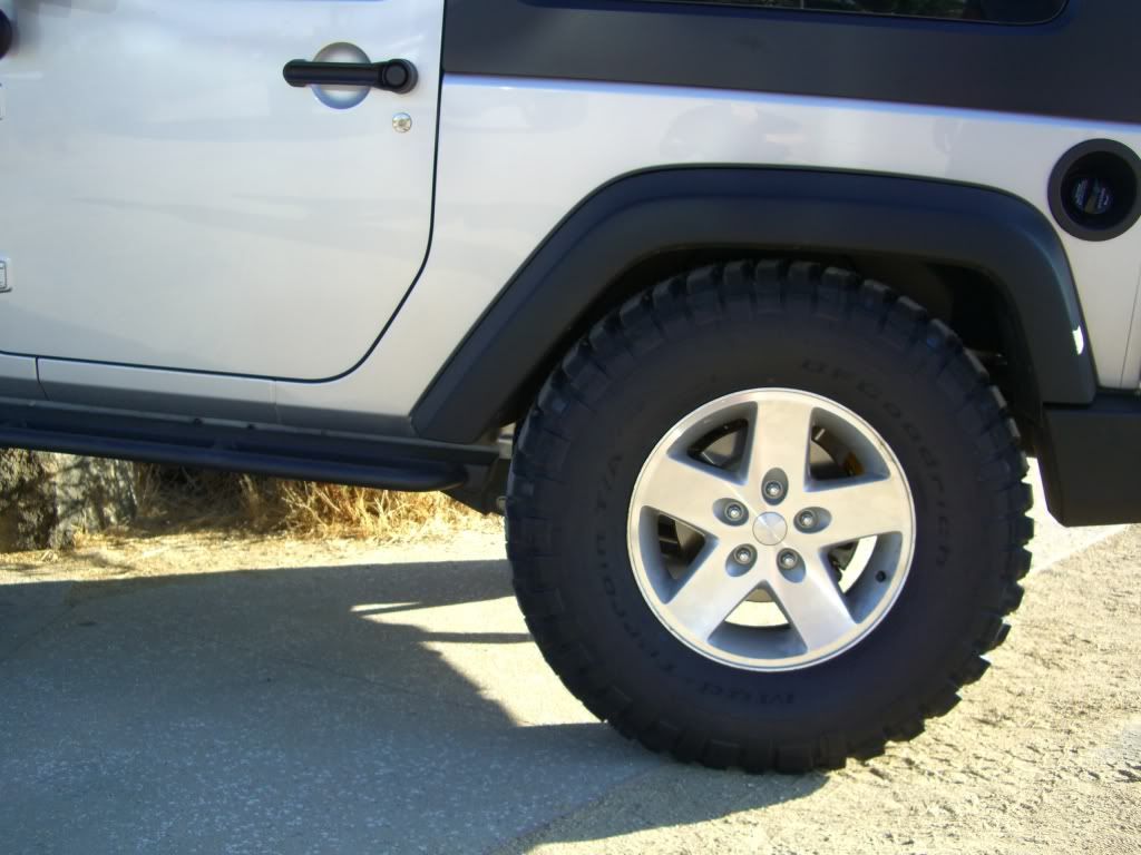

Default Helping another JKer make up his mind :)
