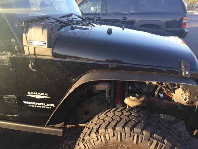

Welcome to the forum!! I have the rugged ridge, it works. During the install my tube that is supposed to run behind the spring then up to the windshield wouldn't let me install the front quarter panel without it bowing out and looking bad. I fixed by cutting a gap for the tube in the inner fender. I am seriously thinking about getting the Ripp cold air intake for the snorkel just because I don't like the clamps that hold the factory air box together. Rugged Ridge looks awesome and works! Click image for larger version

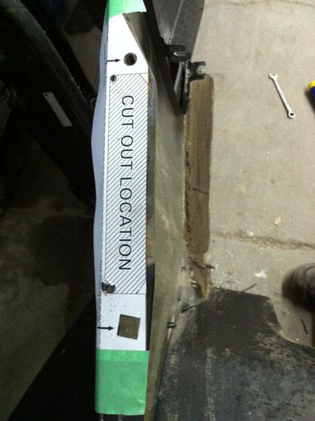

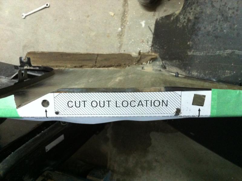

ID:	608515 Oh ya and this template it comes with sucks. I ran it through the photocopier adjust the zoom until it was sized properly

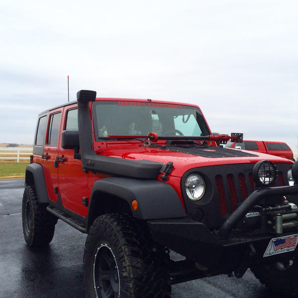

You really can't go wrong as long as you don't get the Chinese-made knockoff version. I think it's called the Red Rock 4x4 or something similar. I have friends that have the Rugged Ridge and they love it, I love my AEV, and others love their Wild Boar, Volant, ARB, or River Raider. Just choose which ever one looks the best to you and that you can afford. I think Rugged Ridge is the only one that can go back to stock but that obviously wasn't a big deal for me or many others. If I can sway you towards AEV, they're made in Michigan of ABS plastic (think whitewater kayak plastic) and have been tested on numerous expeditions into the heart of the wilderness without fail. Sure, the looks aren't for everyone but I love it more every time I see it.

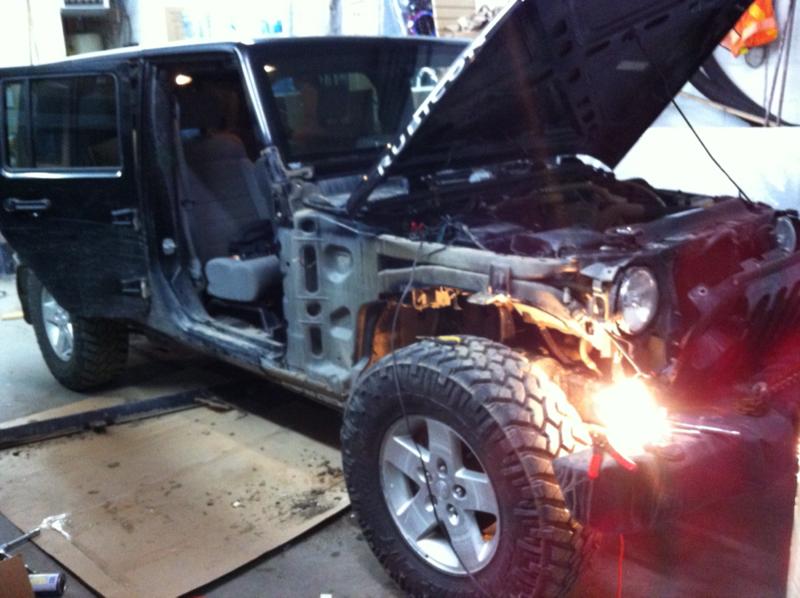

Not sure on the river raider. I've got the rugged ridge one and I'm very happy with it. Not gonna lie the install is a PITA but once done I was very happy. Oh and while the instructions are plentiful, reading them before starting the task will help much.
