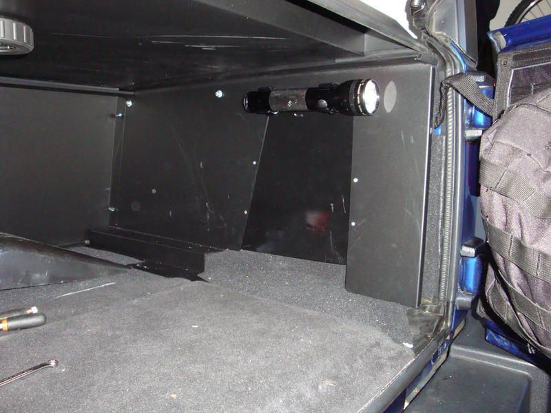

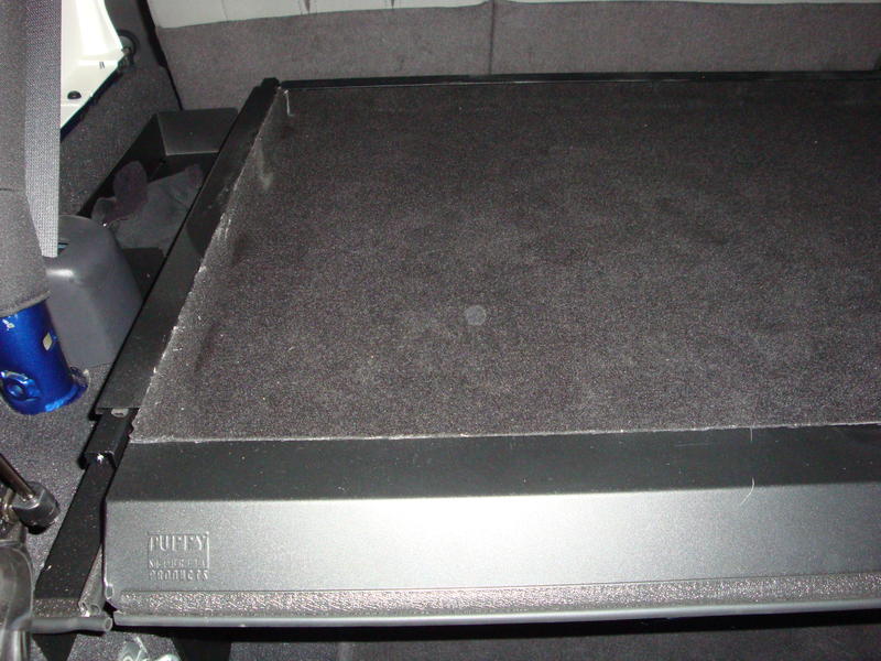

I have not put any anchors in place yet, but I did carpet the top and fill in the gaping hole that was left by me not having the factory sub.
The carpet looks good. Where did you get it from? Does it match the factory carpet its hard to tell from the pics.
I like what you did with that gap. I have the sub so it wasn't an issue for me. Gotta wonder why they just didn't make two different panels though!!
Found the carpet at Meijer, not an exact match, but it does not stand out. I was curious with the one size fits all model as well.
