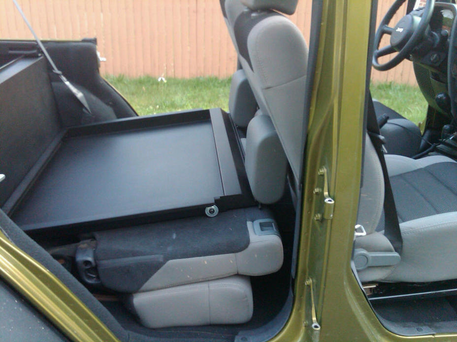

I just put one in last week. The top can come out without tools, same with the piece flat up against the seats. So you can still haul longer stuff by folding down the seats. I haven't tried the deck with the soft top yet (it's been hanging in the garage for a couple months now). I'll go out later and see if the top panel can slide somewhere while off, I'll get you some pics too.

Some top options, maybe .

Originally Posted by wtowen
First, how ,much room is there between the front of teh tuffy and the back seats? With the Flexitrunk I can just get myhand in there to hook up the tether for a child seat. I also find the inch or so of space perfect to slide the back and side windows into.
Don't think you are going to get that much room. I had to trim the top rails to keep from digging into the back seat. With the rails trimmed, there's about 1-2" of room all the way down.
I know the tuffy drains to the front. I assume that means any water just goes under the back seats? Also, when It does get wet in back, how do you get teh carpet out to dry it (problem with the flexitrunk too) .
Where exactly do you think the water "drains" when you have the top down? Same place for the Security Deck. It just gets a little concentrated where the drain holes are.
It looks like you can lift the top up without removing it if you need to haul something too big to fit under it. True?
Yup. The top just lifts up and out with little effort. Remove 4 thumb screws and you get the whole back open pretty much like it wasn't there.
Does the softtop down interfere? I often will pick up larger items while out like at homedepot and with the flexitruck I can just remove the top pieces and slide them in the front of teh trunk. Can you just tilt up the top on the tuffy to fit larger items. Since the tuffy top is one big piece, I assume there would be no place to put it if you removed it entirely.
Best left at home before you need to worry about where to store it. Much like removing the doors.
Finally, anyone know how the interior size of the tuffy compares to teh flexitrunk? I'm guessing they are nearly identical.
Don't really know about the flexitrunk. I do know that there's a lot more storage options with the Security Deck since you can pack the "trunk" to the hilt and still pile stuff on the cover. I like the security of the cover and the fact that it keeps my tools and other crap from floating around off road.
Thanks
You are welcome.
