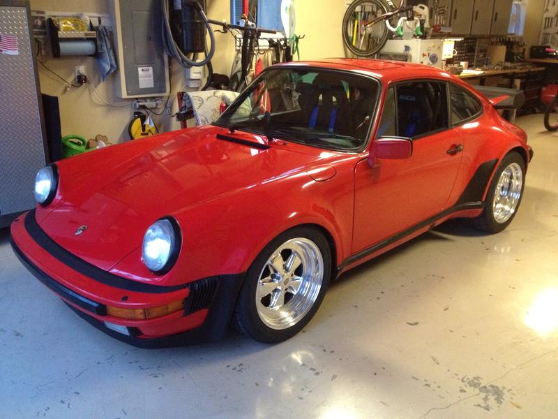

LOL, I think I rolled over a WRZ yesterday
Yes, I've sent in 4 data files so far and have gotten the tune to a point that this is the hardest pullin monster I've ever build next to my 930 but of course we're talkin magnitudes of difference in money spent

Nice ride bro..... 30 year PCA and SCCA club racer... Built a ton of cars for the Boys at microsoft... As they built their empire.... Had a shop with my x father inlaw "Tiad West Performance". my only water cooled Porsche.... 944 Turbo with the little 2.4L pushing 530 at the wheels... Lots of fun and a ton of great racin. Again... Very happy for ya... You're in great hands.... Wes is the shit when it comes to tuning... Ive been pushing him to work with me on my blown Hemi...work up a front mount twin kit and see what we can do at the track. I just installed my BAP ( spare parts from my last hemi build) last weekend... So now i just need to order the head studs and BOV spring from Wes.... And rock mine to 12 psi.... Stoked
