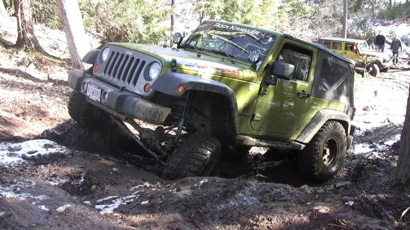

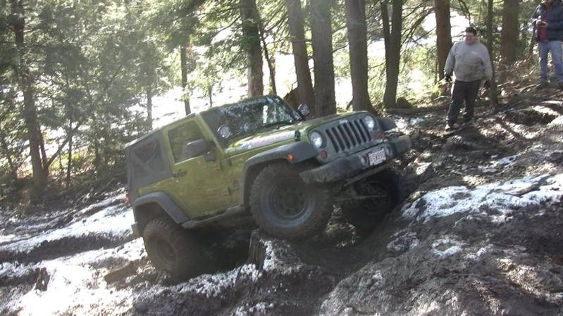

CERTAINLY not gonna be king of the flexers, but here's my teraflex 2.5" bb flexing stock and now on 35's

Just put them on last week, so that's all I've got for flex pics so far.... Cut me some slack lol

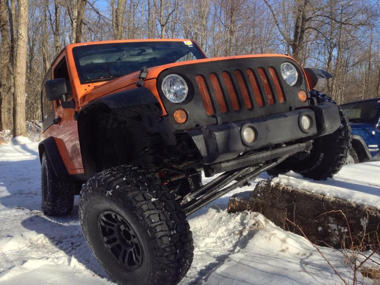

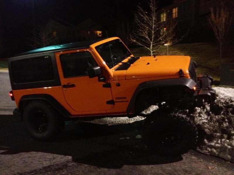

In the lifts I've seen, the RK has crazy flex. This is a guy in my club with the 2.5" max travel. This is not full flex but you get the idea. And note, those are stock fenders so the flex looks less than others with flats.

And this is why I'm leaning towards the RK 2.5 max travel. Thats sick!

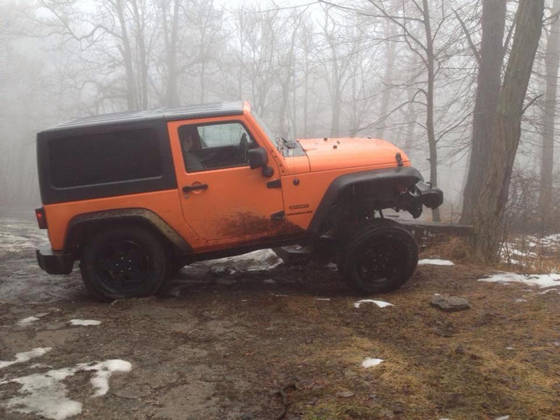

I have about 2 inches of lift. My jeep has 19/60 springs and a 3/4inch spacer up front. Disconnected I get some decent flex. Flex is all about bumpstop height and limiting factor for down travel.
