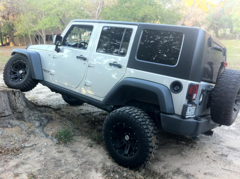

1. 35s should fit but if you go off road their little to no articulation w/ that
2. 305 is a 33" tire and they will deffinatly fit IMO I would run the 33s and I think it looks better and rides better on a stocker
Here is a pic. of when I had 32s on stock w/ a 2.5" lift to give you an Idea
Attachment 258500Attachment 258501

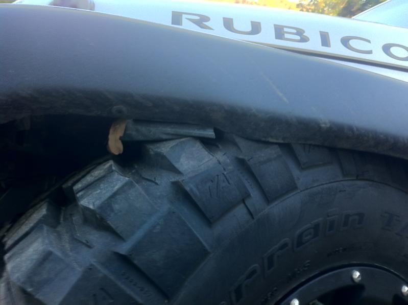

305/65R17 pictured with teraflex leveling kit. It DOES rub disconnected. Mine measure close to 32.5" mounted on the jeep. A 305/65R18 should measure 33.5" or so and will rub worse.
