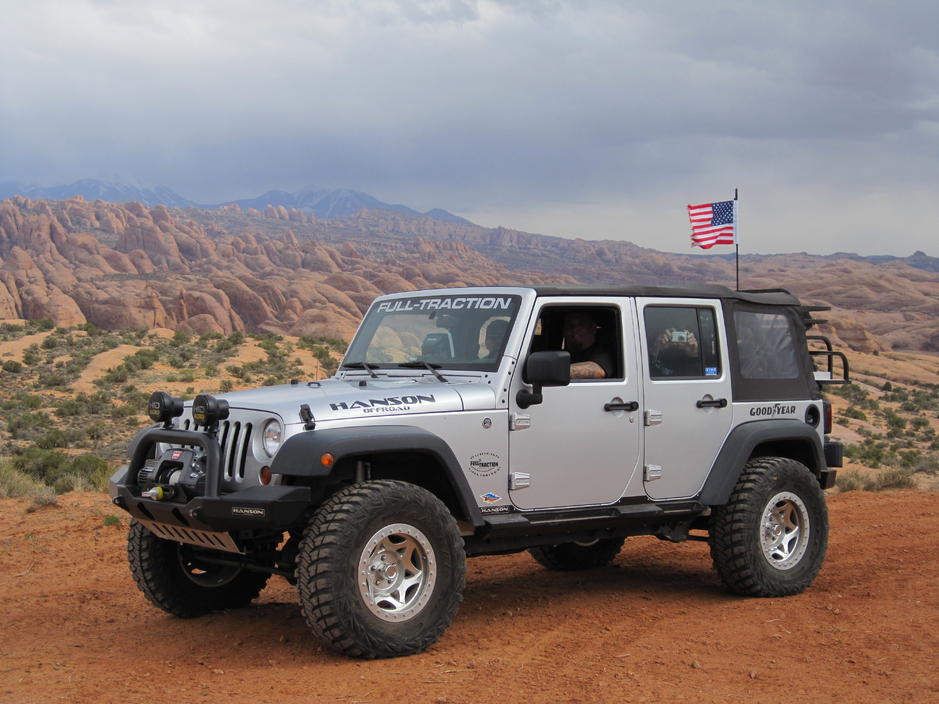

I can get pictures of the kit if you like, but its the same arms as the ultimate kit, except with different bushings.
moad testing, 3" and 35's
