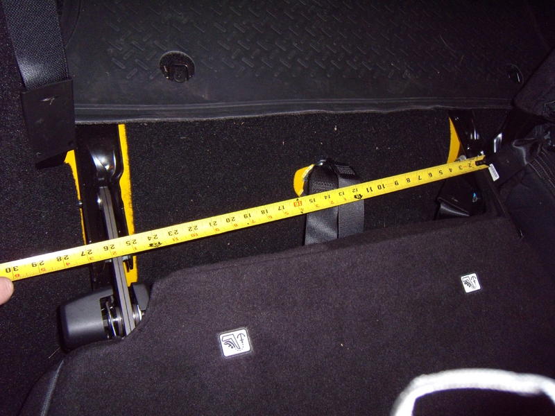

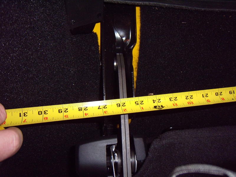

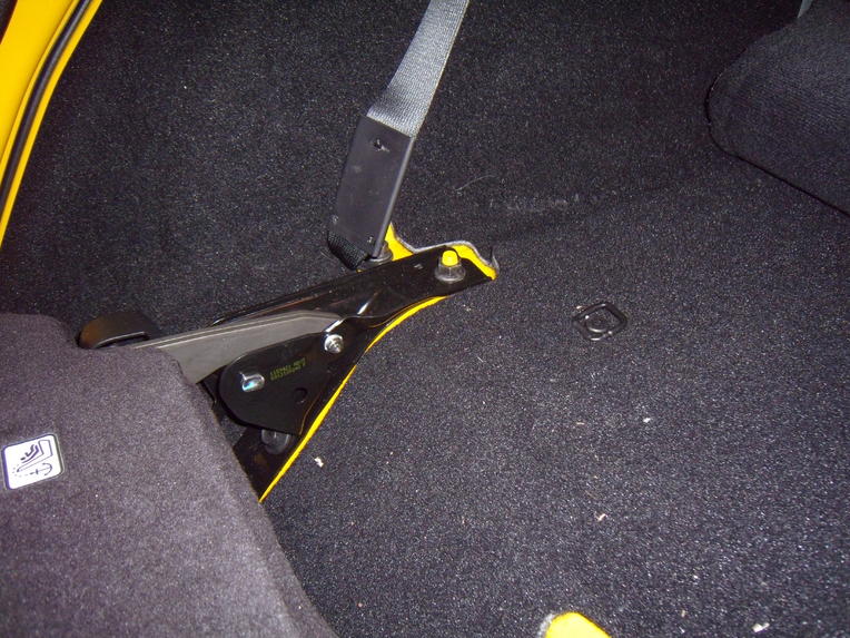

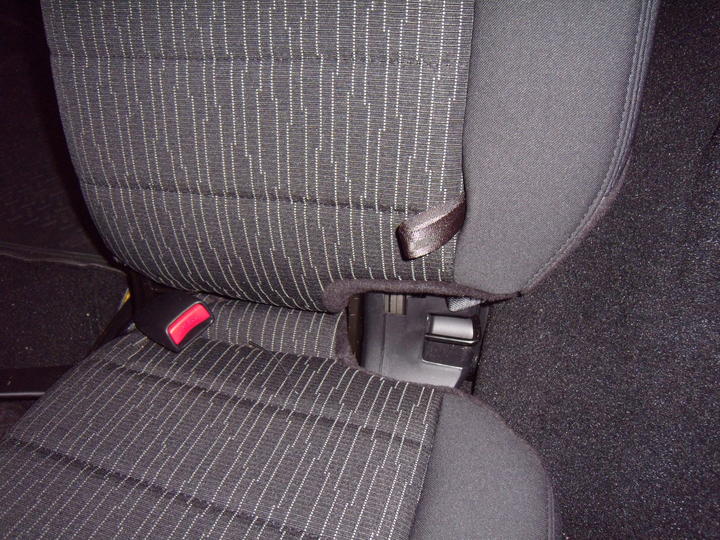

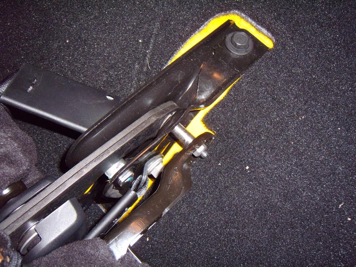

Ok, I took some pics of my 11 Sahara rear seat. Let me first start off by saying anything is possible, but this is not going to be a case of just order half a seat and bolt it in. From the pics I posted, you can see that the larget seat is about 27 inches from hinge to hinge. The other seat uses one hinge and is connected to the larger seat hinge in between the seats. I also took a picture of the smaller seat front. You will have to figure out a way to move the seatbelt clip, and the fabric on the seat will not look correct. the seat fabric could be fixed with a seat cover, but moving the seatbelt clip could become a safety issue. If you end up doing it, I would love to see the pics.
Good luck... Hope I helped.

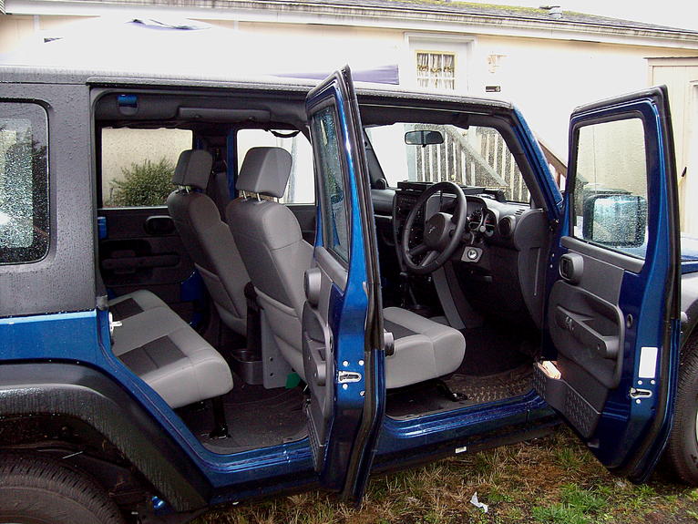

Hello there, I have a 2010 right hand drive Unlimited, and the rear seats are the same as all the left hand drives.
