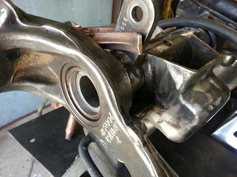

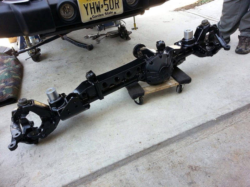

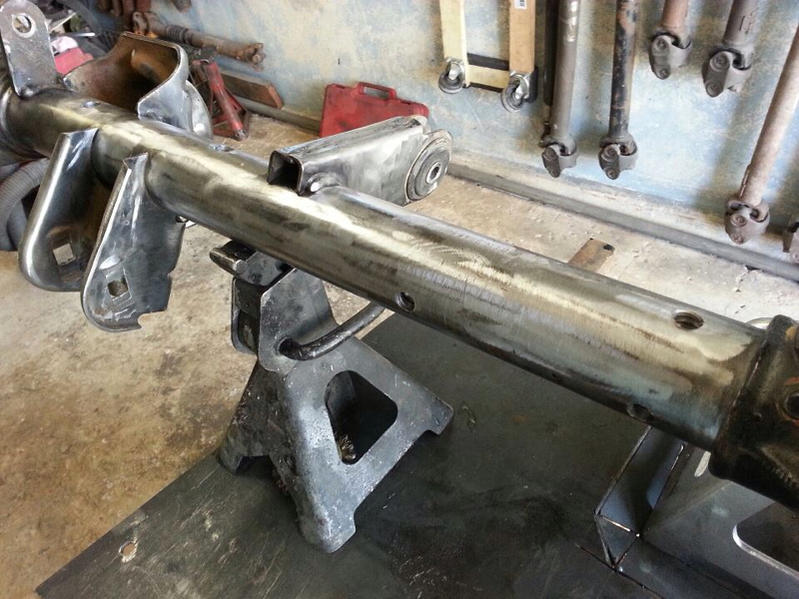

Old Feb 2, 2014 | 05:10 PM
VASYLfromUKRAINE's Avatar
Posts: 128
From: HELMETTA NEW JERSEY
no problem here. did my year ago. very happy!!!
