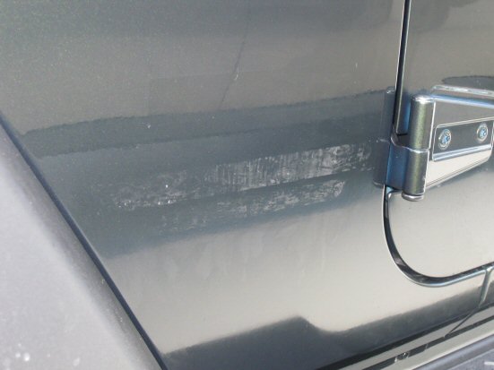

hello everyone.....gotta little problem.....thought I would take my jeep stickers off after reading here.....only problem...I seem to have alot of residue left behind....I started using goo off on it but if you look at the picture...this is where I'm at....any assistance?

i posted in the other thread... use brake cleaner, but rub lightly and do it in the cool shade.. apply wax after.

WD40 helped me get the residue off and then followed it with rubbing alcohol.
Then a good coat of wax.

Simple Green.

wd40 will work..but wax afterwards..

not sure if you can get it where you are from, but there is a product called Acrysol, removes glue and other contaminants on paint.
Local auto part store may have it!

i used adhesive remover from auto parts store. also picked up some microfiber cloth. sprayed on and left for a minute or two. buff with cloth.
just keep buffing with remover and cloth. yes it will take some elbow grease but no damage to paint.
nice wash in the area, and youre good to go..

A big eraser. Seriously.

Get some 3M Adhesive Remover. Its for automotive use and wont harm your paint.

i used goo off. it worked. just had to let set for a few mins. did it like twice and let set for a few mins each time
