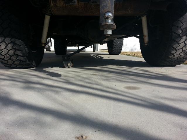

Sorry guys, just got back on. A one is this the trac bar, or sway bar? I'm not sure what was done to it, I bought it, and the list was done already.
Attachment 434870
That aftermarket mount on the track bar breaks the stock mount more then you know
Couple of options get the stock mount welded back on and buy a better rear track bar mount or grind off the stock mount and get a custom mount welded to the axle

Sorry I just looked at the first pictures better
Grind off the rest of the stock mount and get a new mount welded on
Attachment 434870
Trac bar to answer your question. Sway bars run vertically from axel to frame. I have quick disconnects in the front the rear I
