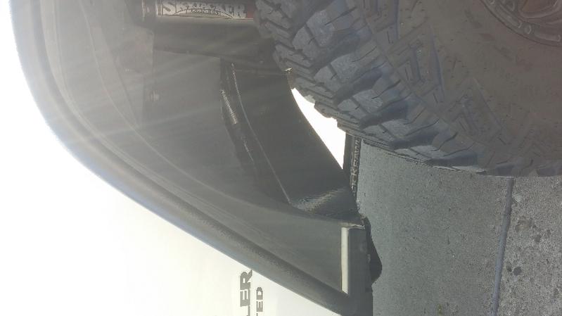

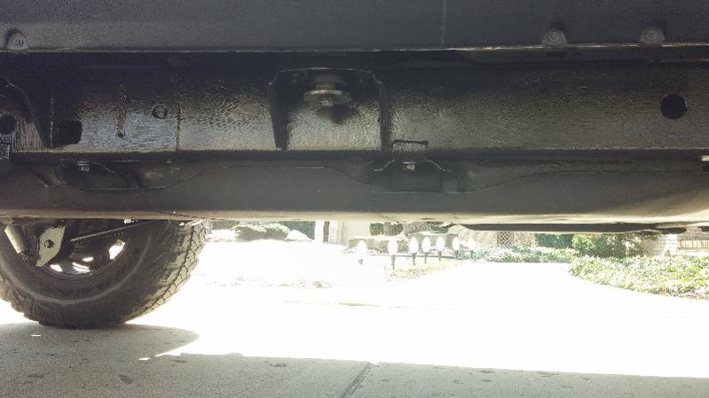

I use a product called fluid film. Its a brush or spray on coating that stays greasy but protects amazing.
Ive used it every year on my 08 and zero rust anywhere underneath through years of salt covered roads in Michigan
Attachment 542057
Attachment 542058
Attachment 542057
Sent from my LG-LS980 using JK-Forum
That stuff looks great will it stick to your closes or hands?
Oh yeah...its like the consistency of pudding. But it is amazing at how well it works. Smells good too ...lol
