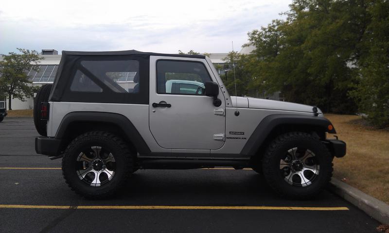

Old Aug 21, 2012 | 06:08 AM
Rattlez213's Avatar
Posts: 6
From: Rochester, NY
I know this thead is a little older, but I was searching for the same answer about the rake of the 2012 models. I have a pic that is the most level one I have taken that shows the rake. Yes, the 2012 look to be about an inch different front to rear. It is definitely easier to see on the unlimited, and when parking in my driveway on a slight incline it actually looks level, so I was looking for an definitive answer. So, if anyone else is looking, just open the pic and use your mouse cursor to see the difference.
33's with no lift yet.
