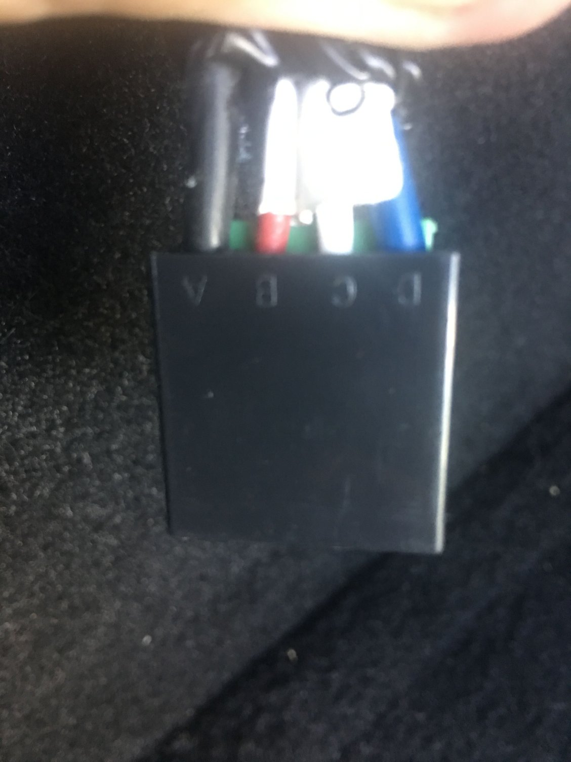

I recently bought my 2nd JKU (bought an 11 new and now I have a used 14) and it came slightly modified and I have an unknown plug inside the cab and I was hoping you’d all be able to help identify it.
Background: 2014 Sahara Unlimited with LoD Bumpers front/rear (front is winch capable but none is installed), with 2x KC HiLights wired to a rocker switch on the driver’s side, 2.5” OME Spring Lift sitting on 17” Pintlers on 315/70R17 BFGoodrich KO2’s.

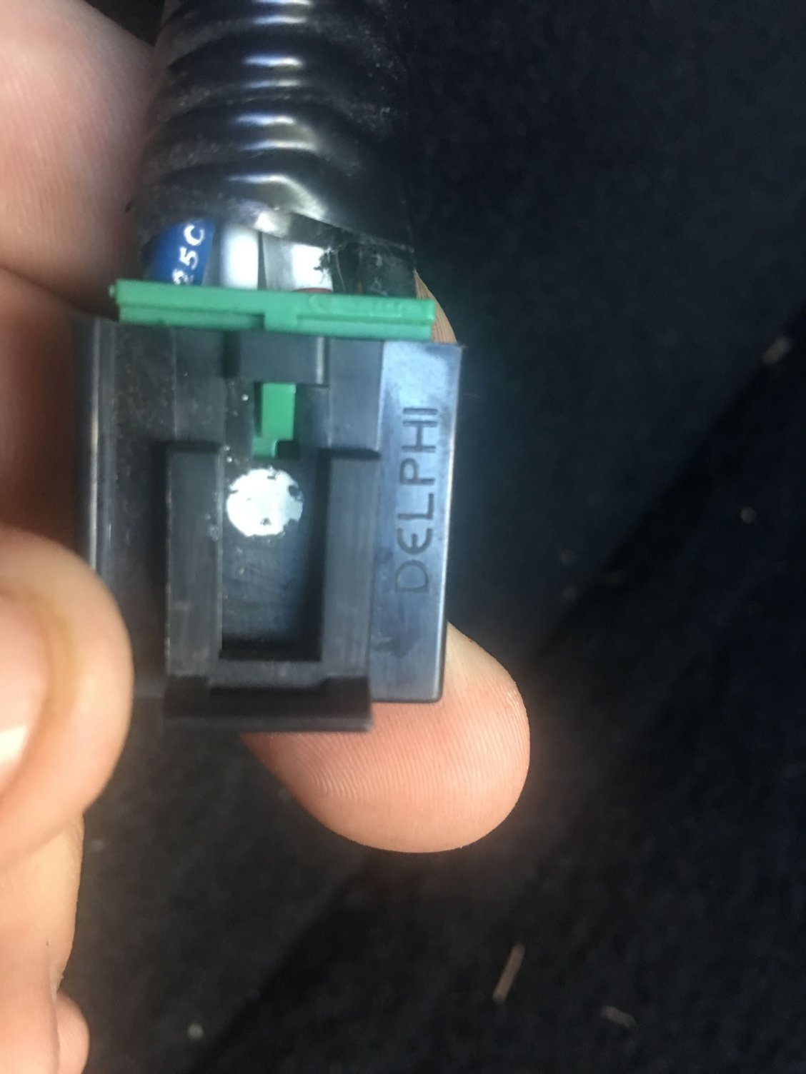

I have attached pictures as well but it is a 4 port plug that is stamped Delphi and PA66 (I know that’s the material the plug is made out of) on one side and DCBA (in that order) on the other. D is Blue Wire, C is White, B is Red, and A is Black. It appears to have been professionally installed and is currently poking out from the passenger’s foot well.
Many thoughts, my guess is interior winch control but I’ve never had one so I haven’t a clue.

Was for a trailer brake controller

fredrok: hadn’t thought about that as I would expect to pull much of a trailer in a JKU but glad to get an idea. Thanks!

You bet. That's what it def is but because of the limited tow capability and sad stock brake system, you'd want e-brakes on a trailer much over 2000lb.
