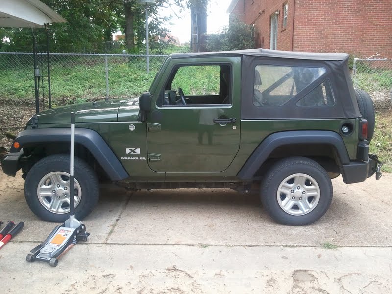

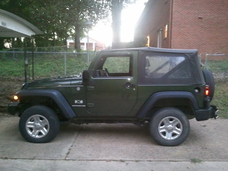

Crawl under your jeep and look at the tags on your front and rear coil springs. The last two digits are what you are looking for. Weakest/softest springs are 12, strongest are 19 for front. In the rear I forget what the lowest are, but the highest are 60(the higher the better). I put a set of Unlimited Ruby springs on my two door last weekend. I started off with 12 Front left 13 Front right and 55 Rear. The jku ruby springs were 18/59. After installation I got a slight lift and it rides much better in my opinion. If your stock coils are low in digits it is worth upgrading.
Before/After
