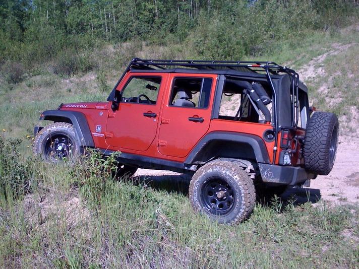

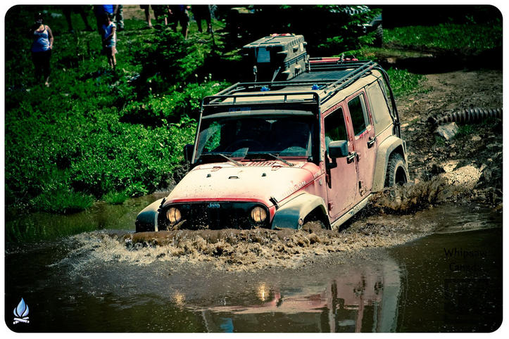

I've seen sahara's with the D30 do some impressive things. I'd skip the exhaust and headers. Get yourself in a TeraFlex 2.5" coil lift with shocks or get the kit with shock extensions and get your hands on some rubi take off shocks. A set of 35" rubber (or 33's if you wanna go easier on your D30 and gears).
If you wanna spend the extra cash and go with 35's you should get a bumper/tire carrier. Since your interested in a rack but possibly spent the extra cash on the 35's and bumper/tire carrier you could opt for the LOD rear bumper/tire carrier and drop an extra $190 for the cargo carrier that mounts on the tire carrier and even the gerry can mounts that attach to the tire carrier for another $190.
Now if you chose to go with a set of 33" rubber you wouldn't need the rear bumper/tire carrier cause the stock tire carrier handles a 33 just fine. In this case you would save approx $500 by goin with the smaller tires and about a $1000 on the bumper/tire carrier and more if you didn't get the cargo add ons I mentioned above. you could drop some coin and get a Gobi roof rack. Very nice rack.
I would throw some skids on your lower control arms and add some EVO C gussetts. As mentioned by another member you could also add some sleeves to your D30. Another commonly overlooked add on would be a front and rear JKS trac bar mount brace. These are beefy add ons that reinforce the weak factory trac bar mounts and help keep them from tearing off.
Now, back to the TF 2.5" lift. I have this lift and added a front adjustable trac bar and will be adding front lower adjustable control arms to help rid flighty steering.
I would also opt for a Superchips flashpak.
So to break it down I run most of what I mentioned above. I live in Canada so EVERYTHING costs more. I got the TF 2.5" coil lift with shock extensions and rubi shocks for about $600. A set of five 33" Goodyear Duratracs for about $1400. I added my Evo Gussetts, lower control arms skids, JKS trac bar braces front and rear and a front adjustable trac bar for about another $600. I managed to get a Gobi roof rack shipped up here for about another $1800 and I picked up a Superchips for $350. So all totaled I dropped about $4750 not including some labor and taxes. Since my initial build I've dropped about another 5K but I was very happy with what I was able to do with the initial 5K.
I recently scored a set of 35" Duratracs and will be putting them on this week but up to this point I have been very happy with my 33's. Here's some pics of my rig with the lift, rack and 33's before I added the rest of the mods.
Hope this helps.
Wayne
