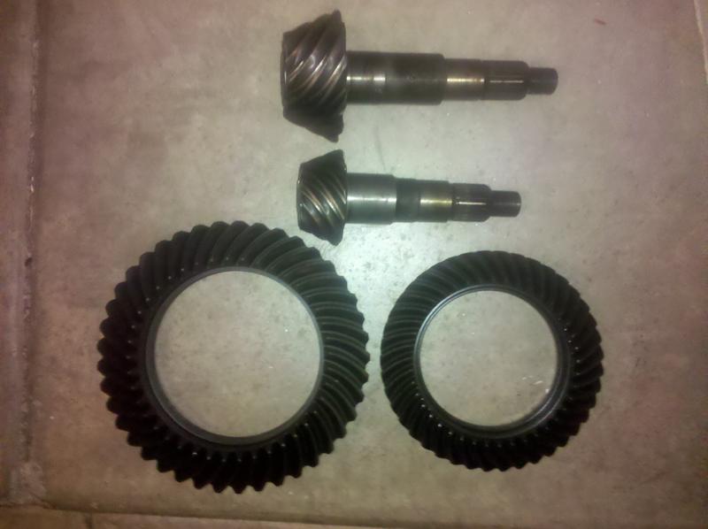

Yeah good idea on the upgrade. It is somewhere in my future wish list too.
Look at the difference in gear sizes between the 44 and the 30. It is scary how much smaller the 30 is.
This is a picture of my stock 3.73 44 and 30 gears.
