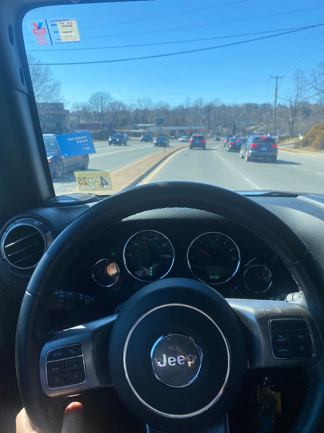

Upgraded my tie rod to the Rock Jock Currentlync unit with upgraded ends and the teraflex flipped drag link. Had ball joints checked and they are good with no immediate need to replace. Tie rod ends are tight as i had everything retorqued the other day.
but driving i notice there a decent size deadspot on steering wheel between 11-12 when driving straight, i know this is a Jeep thing and can vary. It doesent wander, but is there any adjustment i can do through the drag link to keep it centered and have smaller deadspots?
