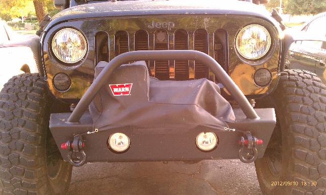

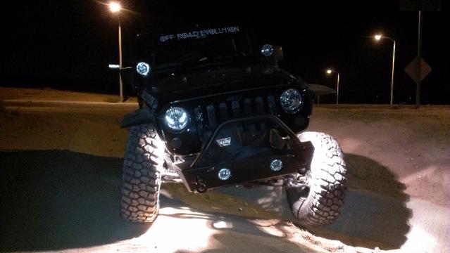

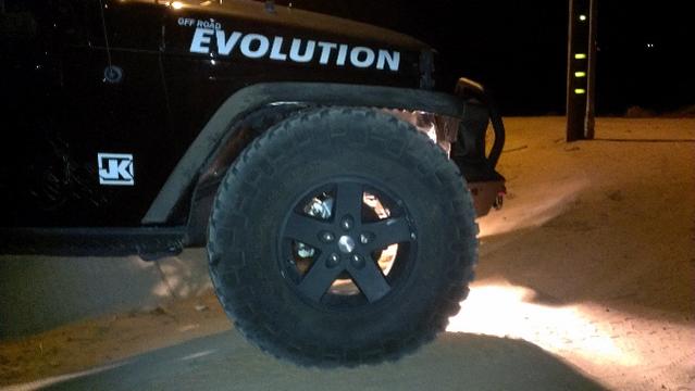

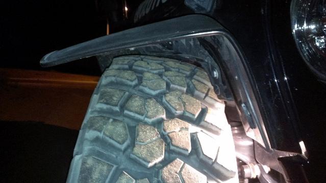

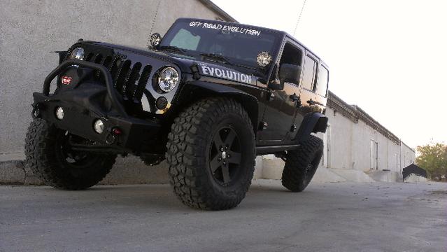

I have the teraflex 2.5" with rough.country 1.25" body lift and I clear 37's no problem. Body lift cost me $100 shipped from eBay and only took a couple of hours to install by myself

Bob-0
Do you have pictures of your jeep sitting flat? Would also like to see the gap between the body and rear bumper if you have one. Thanks!!!

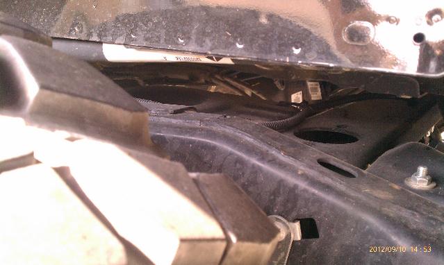

Left rear wheel well

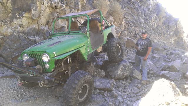

Lol thats my buddies cj, I don't kno how it got posted
