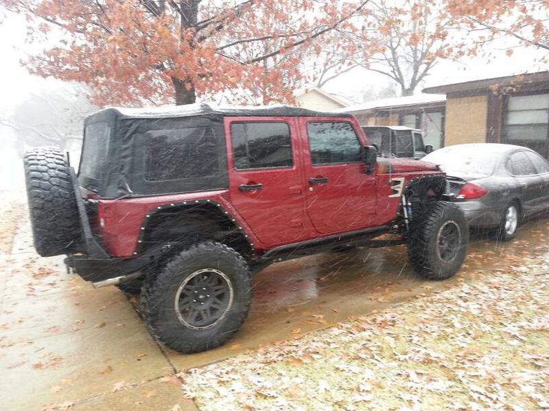

I have 37's km2's but have 538 's and it rides fine to me now I wouldn't know how it feels with a lower gear but from what I read on here you probably should change gears . I would think it would lag a little. Click image for larger version
