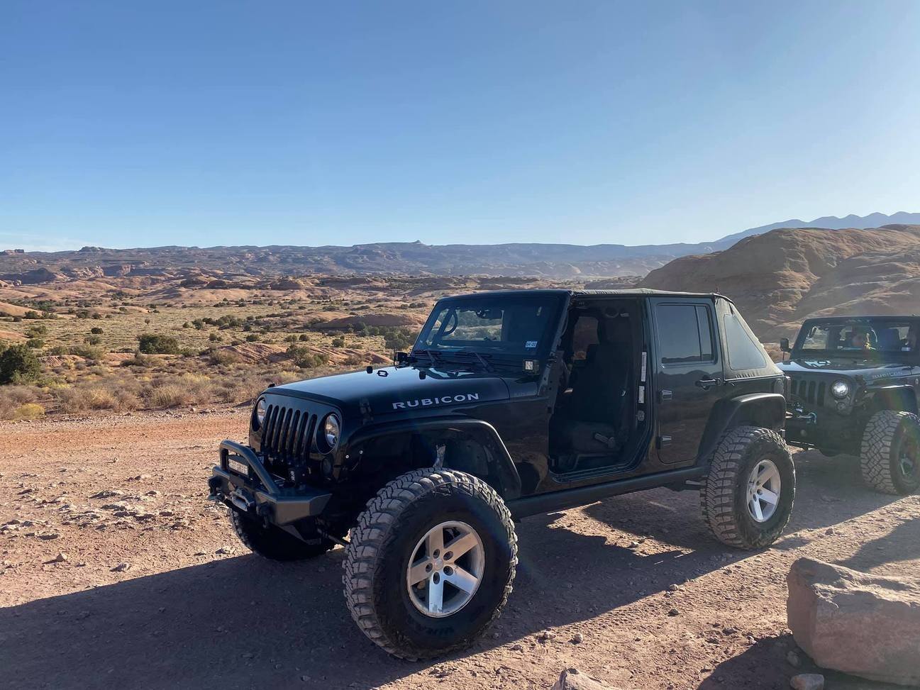

This is mine...now on 39s, 5.13s. I did upgrade to a dynatrac front axle housing (Nothing broke, I just wanted it)...but guess what? The axle shafts and all the guts are still STOCK from 2012 OEM equipment. I'm not going to replace them until they break. and I'm 18mos into the 39s setup. Steering is all stock except the tierod (Synergy, 5yrs ago) which I only upgraded for offroading contacts with rocks. This thing drives like a dream (for a JK).

BLK Hole, nice looking Jeep. What are the wheels you have on it?
Old Jun 23, 2022 | 02:00 PM
BLK HOLE's Avatar
Joined: Sep 2020
Posts: 100
Likes: 19
From: San Antonio
Thank you.
These - https://www.quadratec.com/p/quadrate...jk-jl/machined

BLK HOLE, Those wheels have 5.2" Backspacing, are you running spacers? any clearance issues?
Old Jun 24, 2022 | 06:57 AM
BLK HOLE's Avatar
Joined: Sep 2020
Posts: 100
Likes: 19
From: San Antonio
With 12.5" tires and 37s they rubbed slightly...I allowed it. With the 13.5" tires I had to add spacers. No rubbing now.
