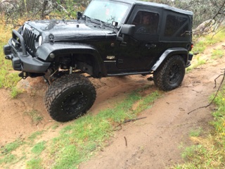

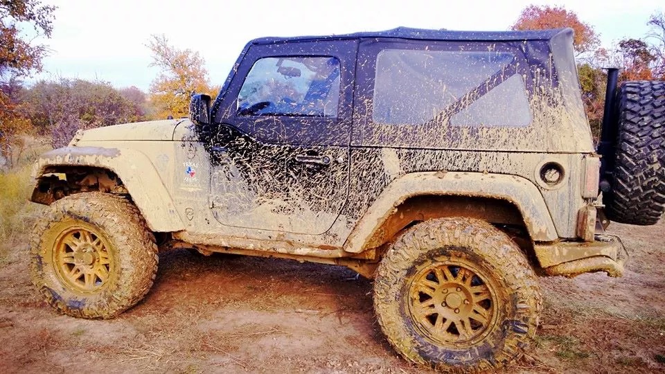

I did my uppers with the Gila Peel and Cling window tint from Autozone. I installed it like you would normal tint though. Plenty of soapy water solution and a squeegee. I've had the tint on for almost 4 years now, and it still looks great. I have no peeling or bubble issues.
These are the best pics I currently have. I went with the 20%, but it isn't as dark as you would think.
