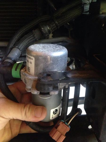

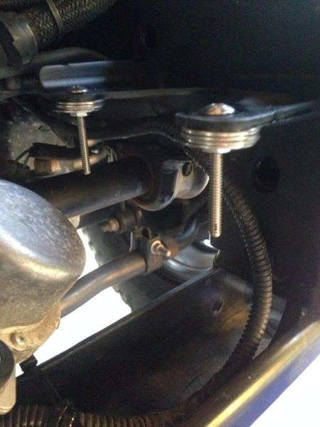

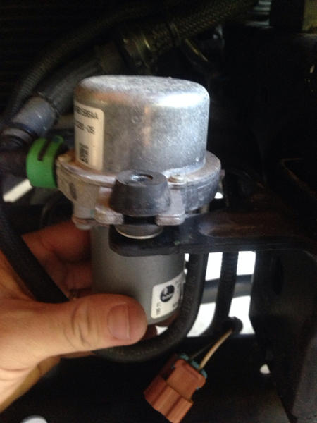

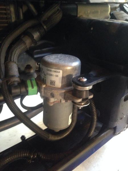

I installed the Ace Engineering Stubby and was able to move the pump from mounting on top of the bracket to the bottom if the bracket and gain enough clearance that I did not have to fully relocate it.
