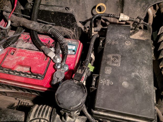

Cleaned out the connections on the TIPM and also cleaned up the grounding post on the TIPM
(Before cleaning)
Also replaced the negative battery terminal and it clamps a bit harder now
Fingers crossed it makes a difference...
