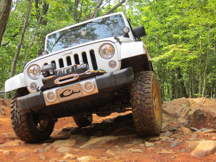

I decided a while back that I wouldn't spend the cash on a new bumper, instead, I figured with the money i'd save I could get a mounting plate, winch, and eventually stubby up the stocker. I'm glad I made that decision.
We tackled the install late yesterday afternoon, and despite the freaking rain and my POS sawzall, the install was very straightforward. Mark off 3.5" on the top and bottom with some tape, and saw off the ends. I ran into issues, but it really is that easy. You don't have to be anywhere near perfect on the cuts, just have to leave enough to be able to drill holes and mount the end caps. My cuts were FAR from perfect. Once cut, stick the end cap on, drill five holes on each side, push the grommets in. Done. Took 30 minutes. Would have taken 15 if I would have had a proper saw. Last part was sticking the air dam back on, with the wings trimmed off.
End result is a clean install and it really opens up the front. I really like the end result. The picture I pasted below isn't the greatest, but you get the idea. For 58 bucks delivered and 30 minutes of work, i'd say the VDP stubby end caps are worth every penny.

Looks good, much better.

thanks man, I appreciate it. I think it definitely made a positive difference in the look of the jeep, and it should help out on the trail too.

Where did you find them for $58 delivered? I want to do that to my Sahara too.

I got mine from Northridge 4x4, but I ordered ACE sliders (they haven't got here yet) at the same time. If you put the code JKFORUM in you'll get a 10% discount and free shipping on orders over 70 bucks. They are great to deal with and have great customer service.

Better stubby pic
