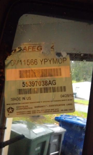

Goo Gone (For the sticker on the replacement glass)

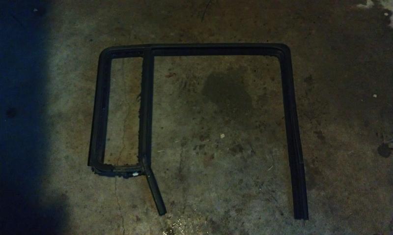

1. You need to install the rubber side window channel opposite the window first. Guide the channel down the window. This side should go in pretty easy
2. Dont worry about the upper part of the seal once step one is complete. The next part is the most difficult, so just take your time.
3. The window needs to go in at an angle, bottom first using the screw as a hinge point. Just like it came out.
4. Spray down the seal with windex to help it slide easier. Can't use too much
5. As you slide the window into place be sure to check all seals inside and outside are lining up properly. Use the other side as a visual reference for seal location.
6. One I got the bottom in place, I slowly pushed on the top to push the window into place. I had to bang on it with my hand a couple times to get it on.
7. After the window pops into place, push the remaining seal into place all the way around.
