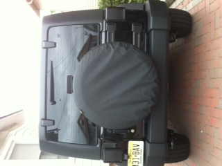

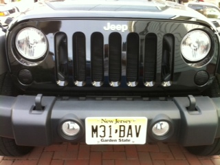

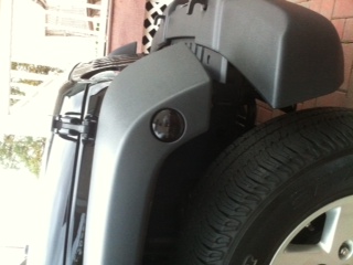

Just wanted to post some pics of my tinted tail, turn, and parking lights. I used 3 coats of VHT Niteshades and 6 coats of DupiColor clear. Little wet sand and polish and they came out perfect. Light shines through very brightly.
