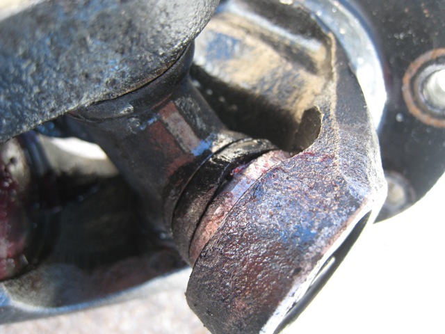

After weeks of messing with my front driveshaft thinking it was the source of my 50 -60 mph rubble strip vibration, swapped out the rear for the stock driveshaft and WOW, smooooooth. No more vibration.
The shafts are JE Reels OE replacement 1310 shafts and only had about 1000 miles on them. I am currently running a 3 inch teraflex lift with full control arms and have the rear pinion set in line with the driveshaft. This adjustment was set before the JE Reels went on, so there wasn't a period of time where the angle was not set correctly.
After pulling the shaft, I noticed that the universal joint at the one end had what looked like little bearings (needle bearings?) poking out from under the rubber ring on one of the joint ears. That is what is in the picture below.
So, what do you all think? If my angles are set right, was this probably only a bad universal? Has anyone had this problem before?

Can say the shafts I got from reel were crap - vibrate at 60+. I went to a local drive line shop and got proper shafts for about 30% less. Reel told me the same thing - send them back and they will decide what is fair. Do a search. Lots of people are having problems with reel shafts.
