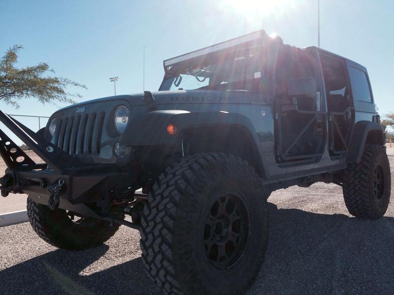

I have them but honestly don't remember my BS. I'll need to measure tomorrow.

5x5 (or 5x127) is the correct pattern. 4.5" backspace is a very common recommendation for 35x12.50 tires. 8-9" is a very popular rim width range. Yes, you can sell the spacers - unless you are considering moving up to 37's or larger?
