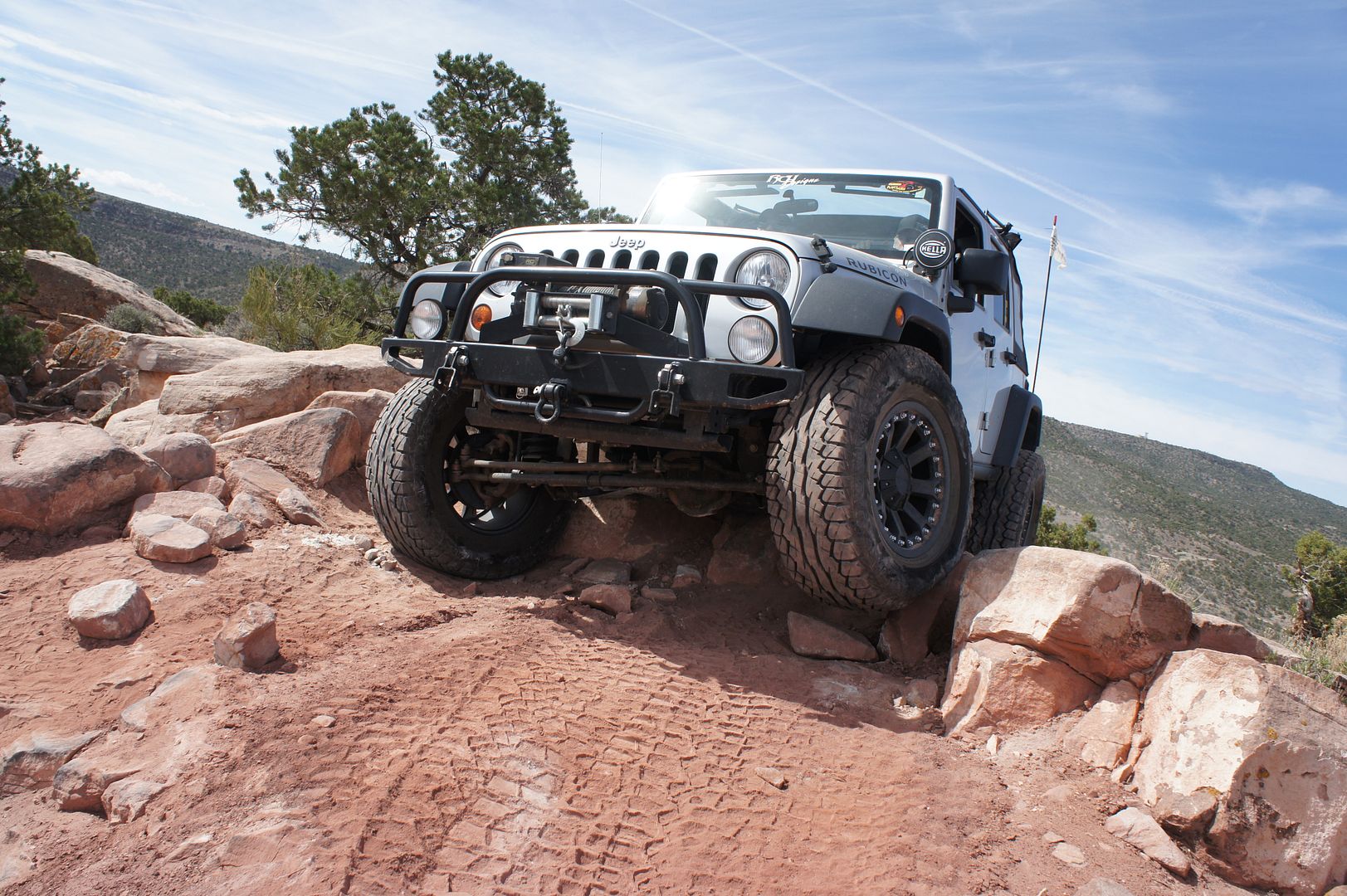

With a good spotter and common sense these work amazing both off and on-road.
This guy went all over Area BFE with them and no issues...
They are a great compromise for those who want to save a little money, enjoy a nice all around ride and looking for an easy install.
Originally Posted by Tripletsi
Stay away from these AEV or Rancho control arm drop brackets if you ever intend to go off road. They'll cause you to catch on everything. Spend the money on a set of front heavy duty LCA's.
Attachment 577078
Attachment 577079
much more clearance ^

I agree these do work amazing on road, and I've heard that Rancho's are much heavier duty than AEV's, so congrats.
Having a spotter isn't always an option. My LCA's would catch on everything from tree roots to basketball sized boulders. Yes I use common sense. Great that they work at Area BFE, front high clearance LCA's are a smarter option for only an additional $150 in my opinion.
